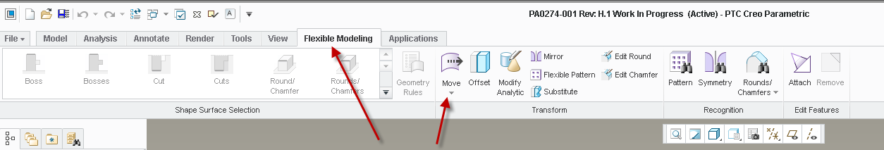

Maybe i'm not explaining myself right on number 1,
Lets say you have a dumb model, was a .stp file. And theirs a feature you need to move 10mm one direction. whats the best way to go about moving that feature.
StephenW
January 27, 2017
Well, that's a tough one. Dumb models are, well, dumb.
In Creo 3, with the right licenses, there is an option called FLEXIBLE MODELING. It's intent is specifically for issues like this.
Since your feature is complicated, I'm not sure this is the right approach though. I've never used it for anything other than some simple adjustments.
I'm hoping this leads you to a potential solution but I'm not really able to guide you to it.
