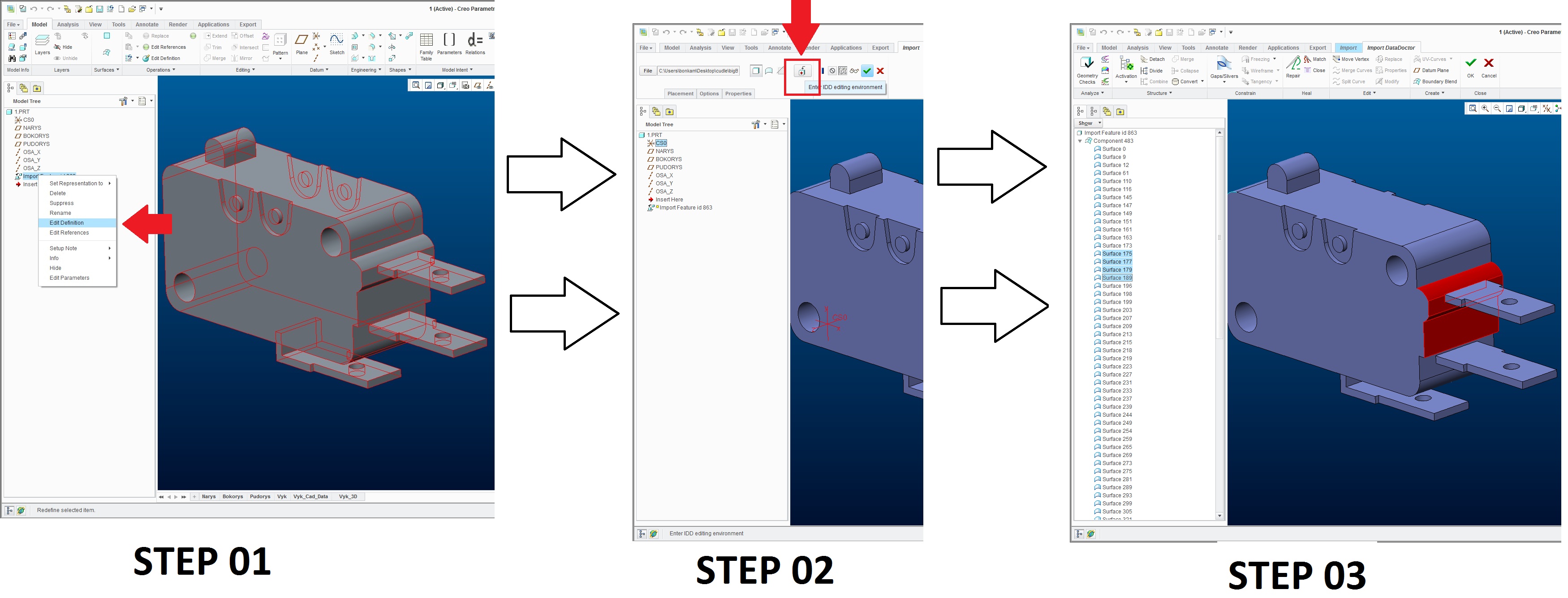

Hello and welcome in forum.
One of many possible way that l know is edit iported geometri directly in Creo. See pictures belowe, that represent editing iported feater in assembly and part level.
Assembly options:
Part options:
l hope it can helps you...
