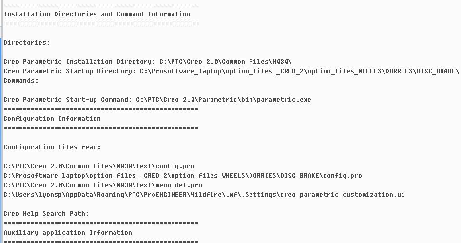

1. create your own custom ribbon with all the commands you need on one ribbon make it more like WF5 if you want, it need to save the creo_parametric_customization.ui in the following location
C:\Users\lyonsp\AppData\Roaming\PTC\ProENGINEER\Wildfire\.wf\.Settings
yes it is store in wildfire setting folder, not creo ?????
make sure the option" load_ui_customization_run_dir" is set to" NO "in your config.pro
with the two thing above set, you will have the same ribbon every time.

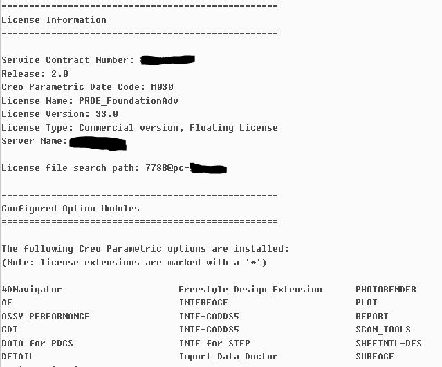

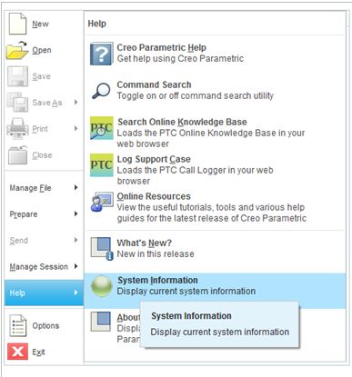

4. The system information window is a very helpful tool to use, to find out what license you are running, what optional modules are loaded, and the load paths for all the setting files, it is located on the file\help
