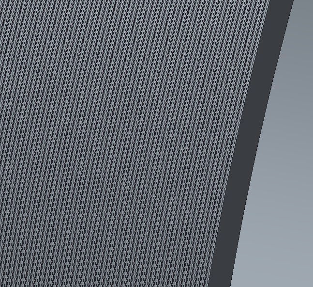

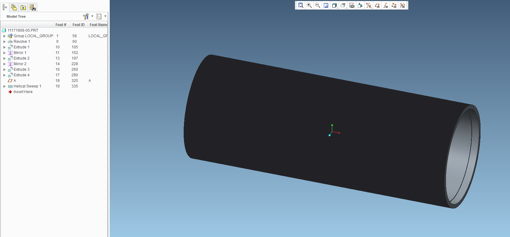

I am trying to create a groove in a roll that I am modeling and I am having issues where the groove is so small that the helical sweep wouldn't regenerate. So, I changed the accuracy of the part to absolute and .0001. The helical sweep will now regenerate, but it takes forever and I can't get the drawing for the assembly this part is in to open. Any suggestions?

Three options spring to mind:
  1. Model the sweep for a small portion of the cylinder and make a note that it should extend the length, then create a detailed view of the that end of the cylinder showing the details of the groove.
  2. Fake the helical part. Just model it as a revolved cut. Should be much faster to regenerate. Then create the detailed view.
  3. Model the sweep as surfaces and then use them to make a solid cut. Should also regenerate faster. Still go with a high magnification detailed view to display the details of the groove.
I would not suggest trying to sketch it in the drawing, that is just asking for trouble.

The problem is that the profile of the groove is so small that its not showing up in the drawing after I sketch it in the model. I might just have to sketch it in the drawing for it to work correctly.

Thanks Marc, that worked well with faking the part with a revolved cut.
