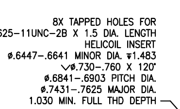

All,
What do you think is the proper way to show a helicoil drilled and tapped hole in a 3D model? I have not used these in a bit. But I recall showing a drill diameter for the tap only. This to me could be somewhat misleading? I guess I am geared towards paperless designs. I'd like to show the finished tap? I don't know? The finished tap as I understand is not a standard tap size? I think I just read that SolidWorks does have the ability to add those tap sizes via its hole functionality. I do add a model of the heli-coil itself in the sub-assy that follows. Of course it's an interference fit. What are your thoughts on this? I am curious what you all think is an acceptable enough method.

If you're talking the Heli-Coil brand or type inserts (made out of diamond-section wire), they use a larger major diameter (use the one they specify - their custom tap), but have the same exact pitch of the thread you specify.  Keenserts are solid inserts, and from what I remember use a larger standard tap (and pitch) than the thread you want.
For modeling purposes, I'd make it an assembly, an model the hole at the minor dia, with a cosmetic thread at the major dia of whatever tap is needed.  Then model the inserts as simple hollow cylinders with the major and minor diameters.  Done.  simple, and your graphics card and processor will thank you, especially in large assemblies.  For some reason, the assemblies I'm working on actually has the helical wire of the Heli-Coils modeled....Ugh!

I don't use them but I know of an application here that uses them regularly. I looked two up and this is what we did on those drawings...2 different styles.
The first specifies all the dimensions.  The second, we add the taps as a BOM item (qty 0 so they don't buy it for every part)

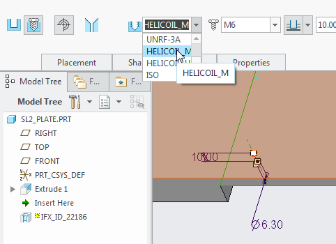

Hi Falco,
not sure if your question is already answered. Maybe this will help anyway.
Find attached a PDF for Helicoil inserts. On page 18ff you find all drilling and tapping information.
I also attached our hole chart for inch and metric Helicoils.

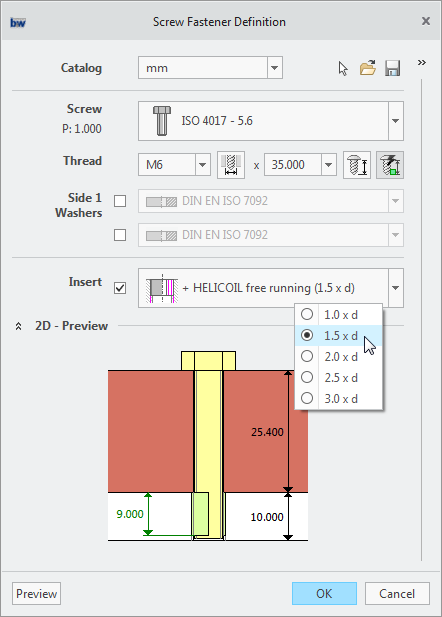

Since Creo 3 you can use the Intelligent Fastener Extension to create fasteners.
It is possible to assemble Inserts with this tool. Use Inserts in IFX
Regards
Oli
