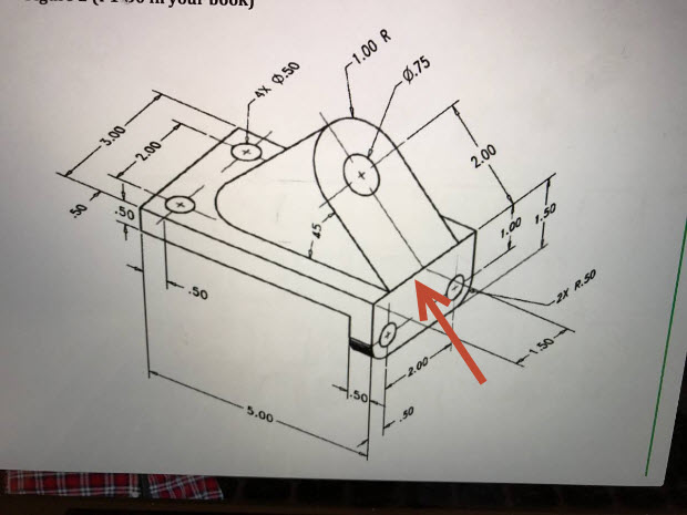

Hello I'm new to Creo and I'm trying to create the top arch feature in the figure. I made a triangle and I don't know how to dimension it.
  • February 22, 2017
  • 6 replies
  • 3488 views
im not sure what to do. If anyone can help, that would be greatly appreciate! Thank you.

Jessica,
If I understand correctly, you will need to make a datum plane at an angle of 45 degrees along the edge, specified in the image below.  Then use this datum plane as the sketching reference.

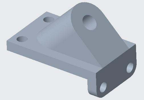

18-Opal
February 22, 2017
You should get something like this:

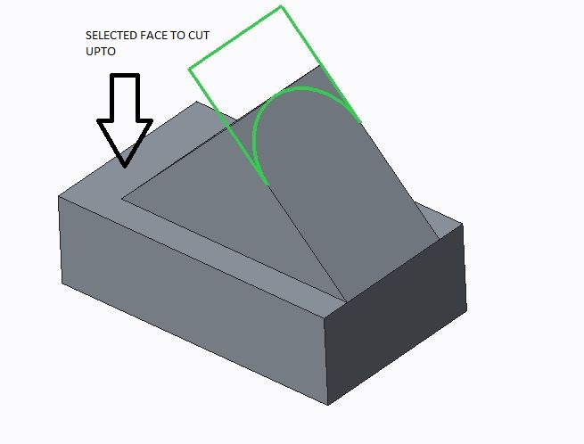

February 23, 2017
This might help.If you have drawn a triangle,just select the angular face for sketch as highlighted in the image and cut it up to the selected face as shown in image.
