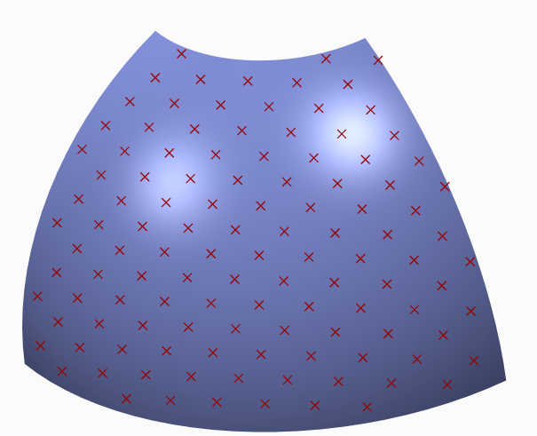

The golf ball models are close but it seems most of the people used a very complex array of radial dimensions to triangulate the points. This is a very tedious operation and has no way to increase or decrease the density of the points. I have to think that I am missing something here. There is no way that that can possibly be the correct solution, is it? Using that method I created this:

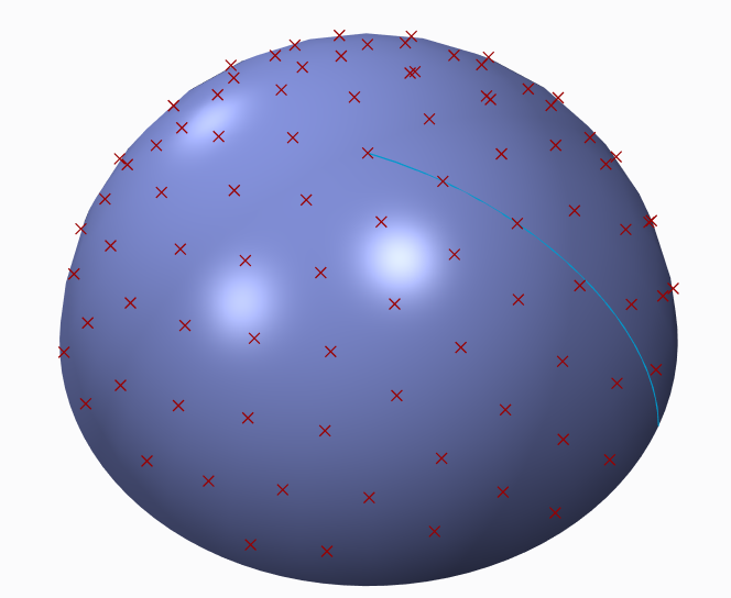

To change the density of points on this version will take hours. On the other hand, I was able to rapidly make one using patterns with points projected onto a surface as well:
Though close, the seams are a total mess. I was really hoping that there was some cool "pattern" option in creo but it does not seem so. I hope my question is clear. I look forward to your help.
