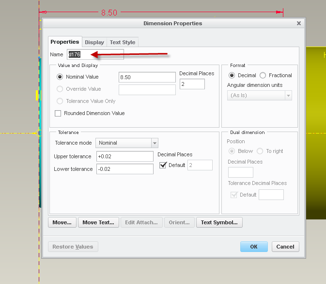

You can rename dimension symbols if you right click on the dimension and select properties.

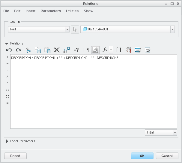

Not sure about printing relations other than using copy and paste in to a text editor or printing a screenshot of the relations editor.
April 24, 2017
see relations defined in attached part.
