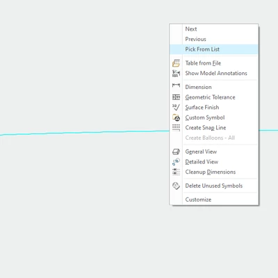

What version of Creo are you using?
When I right click over a view, I get the following menu with the Pick From List.
Arnold
