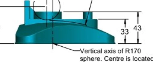

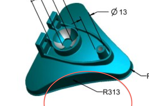

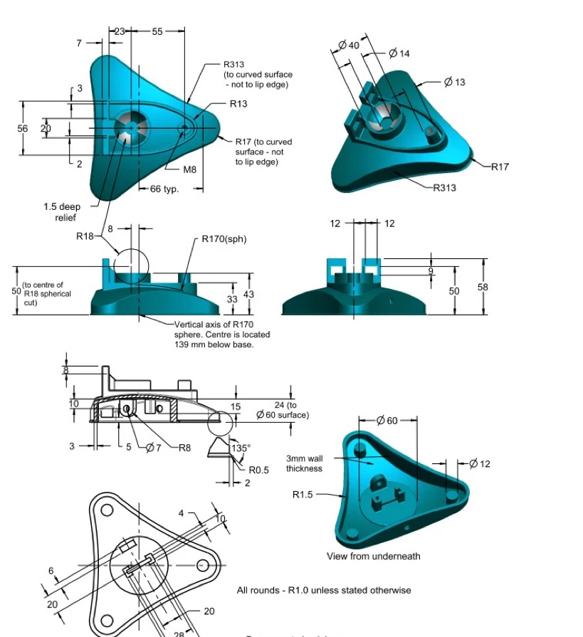

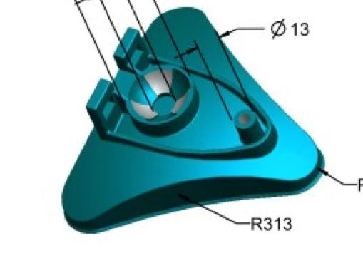

  1. I am wondering if anyone can advise how to create a shape similar to this. It seems to be an extrusion up to another shape but I am not sure how
2. Also I accidently seemed to mess something up in the model tab as I now can not delete them from there.
    Best answer by TomD.inPDX
    I have to reitterate this comment. I mis-understood the R313 and R17 callouts. This is a fairly straight forward extrude but it is missing the draft requirement.
    I created a R170 hemisphere and extruded the triangular shape with the remove "remove material" and flipped the removed material to the outside.
    I don't know what the triangular shape is from the limited details provided.

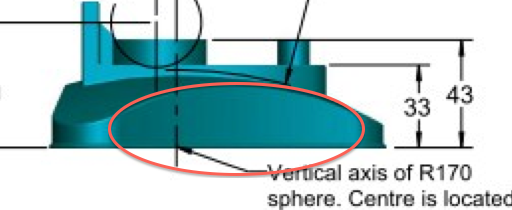

    The part was created with a spherical feature as a primary feature and the rest was added and removed.
    October 2, 2013
    Thanks for replying.
    Sorry but I dont exactly understand what you mean.

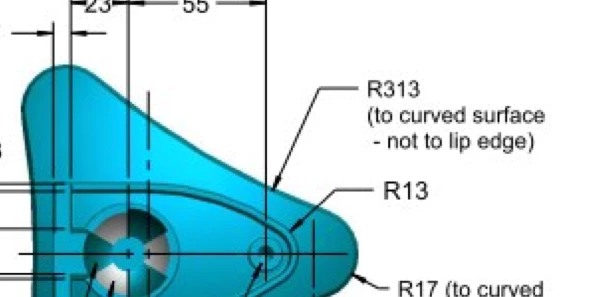

    I started by making a triangle shape then added the rounds at each vertex. I thought from the R313 that I would need to place a large circle so that I could create a remove material extrusion. However it isnt that straightforward as this the height of the vetices are lower than the middle. My thought was I would have to make a r313 extrusion upwards from the bottom to the shape of another circle/arc.
    Thanks for your help.
    October 1, 2013
    Or another way, draw the triangle shape first, and then revolve cut the sphere shape into the top.
    OR draw the triangle shape first and then revolve a surface for the sphere and replace the top surface with the sphere surface. but that's kind of a few extra steps.
    October 2, 2013
    October 2, 2013
    Wow that looks about right. Thanks for all your help so far Antonius!
    So you created the hemisphere, drew a triangle shape-extruded and removed the unnecessary material?
    also how do I do the hemisphere? I am pretty new to Creo and running it on mac so its a lot of messing about.
    Cheers
    P.S. I've attached a more detailed image incase that helps at all.

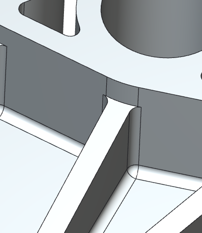

    Matt, you got there pretty much the same way I did. The only difference in interpretation is the upper core removal where I stayed with a 2.5mm wall on the angled face.
    Also have a look at extrude 9... I just used the optional second extrude direction to fill the small void in extrude 6.
    I also see where you had trouble with the fillets in the bottom core removal where the center rib meets the R11. Since rounds don't like jumping boundaries, I had to extrude it.
    Of course, leaving the R11 sharp and radiusing it later would also have solved it. But it is one of those things that can cost you a lot of clicking to find out just what failed.

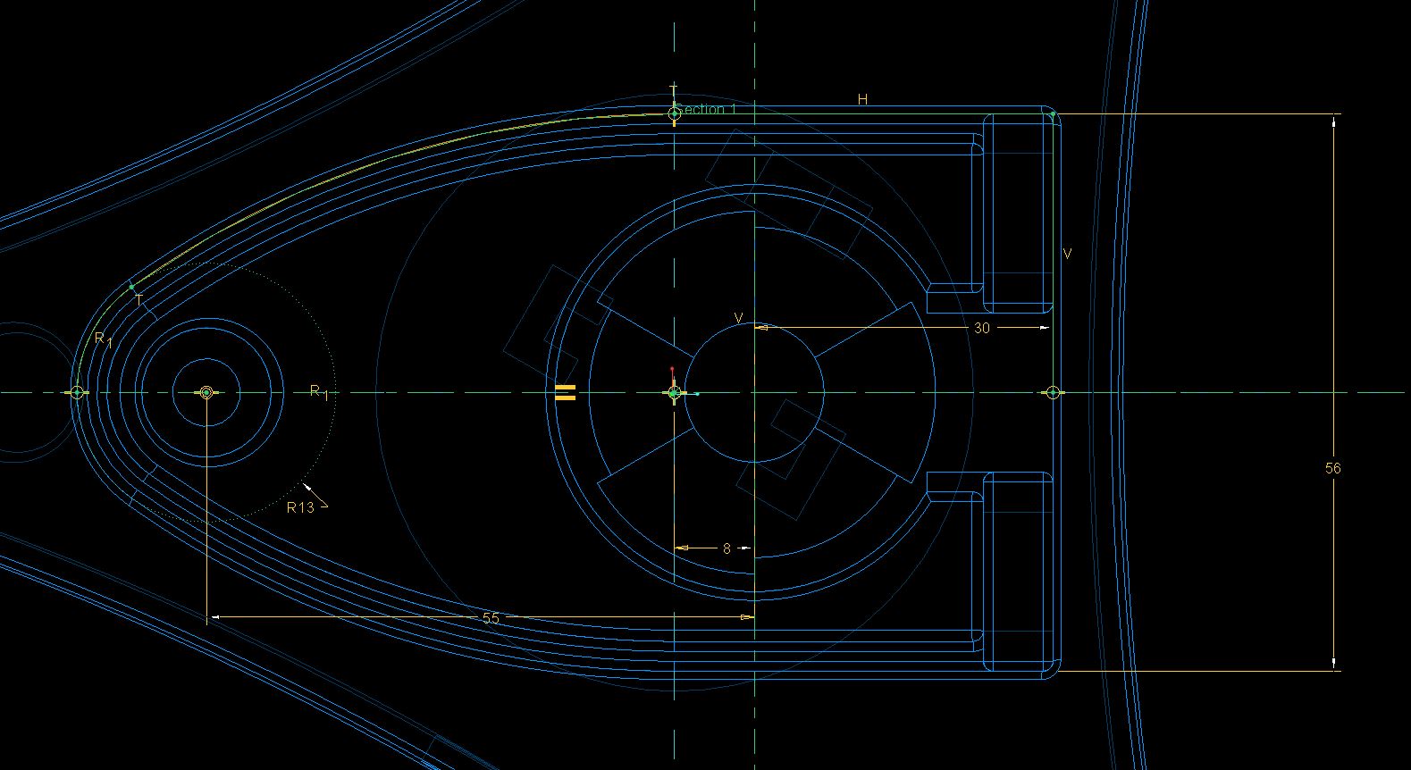

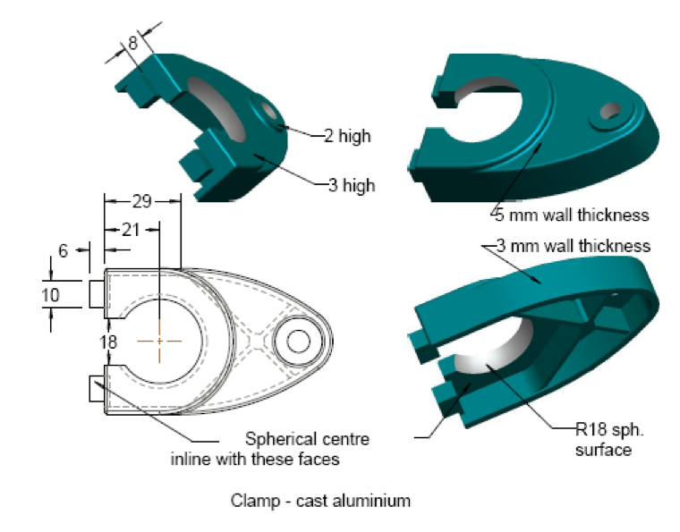

    HI Guys,
    so heres the last pozt to wrap it up
    1. Clamp feature how to especially
      1. "x" form
      2. remove material
      3. base dimensions
      4. Is it possible to do a shell with a dual shell? (top 3mm and bottom 5mm)Screen+Shot+2013-10-19+at+6.41.11+AM.png

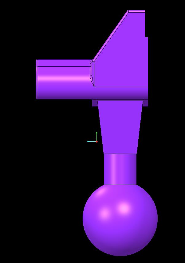

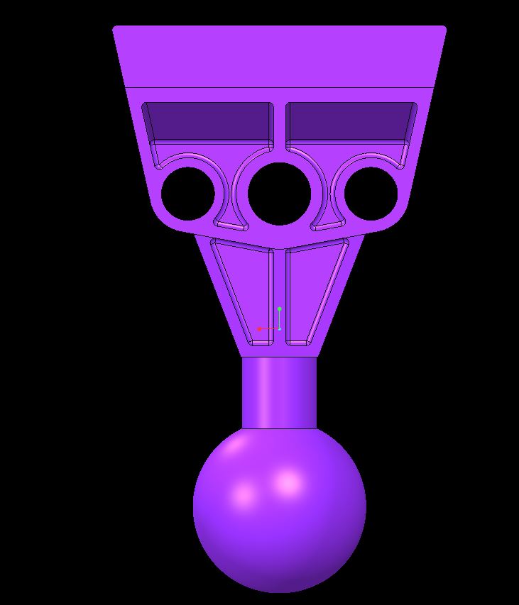

    2. For the previous part, remember the trapezoid section above the cylinder and ball. So far i completd the design but it isnt allowing me to shell out this drawing-Maybe some advice?
    3. Excuse me for dredging up the base again but can anyone explain the barrier type feature? On the top face.
      CHeer fellas and see you.
    October 19, 2013

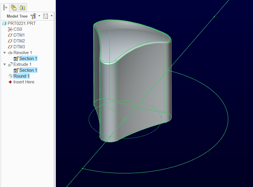

    If those are the only numbers you have, a couple ideas are to create this new part in assembly mode with the other part. Or start measuring the other part and writing the numbers down or make yourself a print.
    I have to look at the rest in a bit.

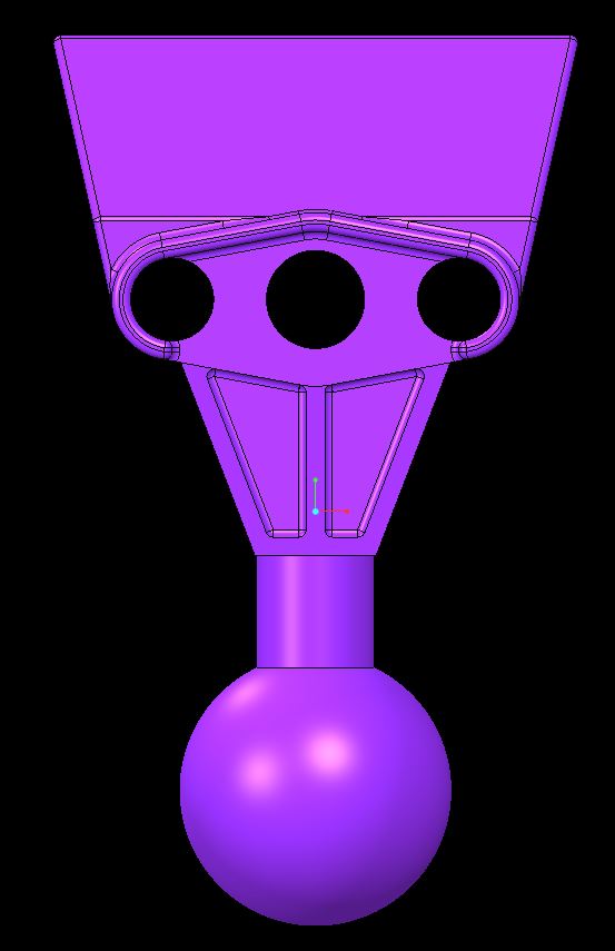

    October 19, 2013
    This is what that shape looks like to me from that other part.
