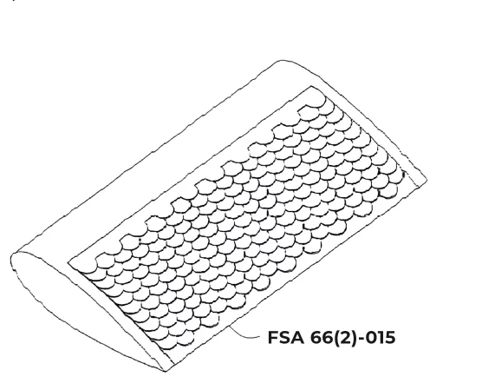

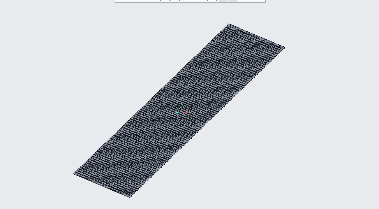

Hello Community, I am working on a Modified Wing Project, For that I want to place a Film like structure over an existing wing. Is there any way to place a rigid object as curved over a curved surface. I have attached all the necessary images and files. help me out on this. Suggest me any method where i can arrive at my end result

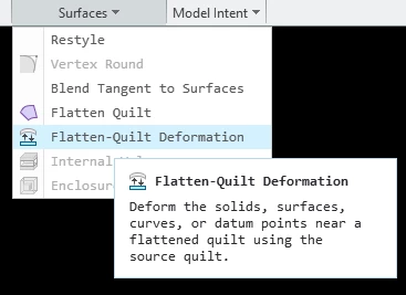

I'd say you should look into the "Flatten Quilt / Deformation" tools
Basically you will: 1) Flatten your curved wing surface to obtain a flat quilt.  2) deform the (flat) textured surface to the shape of the curved wing using the (reverse) deformation from step 1..

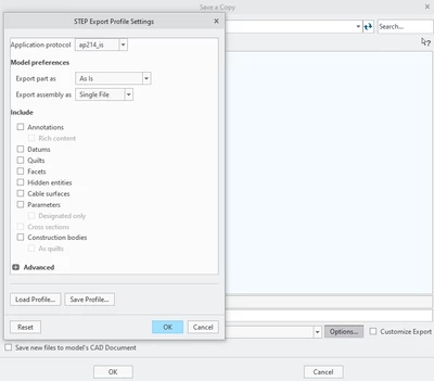

Thank You for Helping me out, I managed to get my intended result, but now the problem is the flatten quilt feature which was formed earlier. I can only able to hide it,  when exporting as an STEP or IGES file the flat quilt is also there, I want to suspend the Flat quilt without suspended other parts like the extruded features and flat-quilt deformation.
You will have to check your export settings.  For example, when doing the save-as, click on the "Options" button and then make sure you are not exporting hidden or construction entities.
