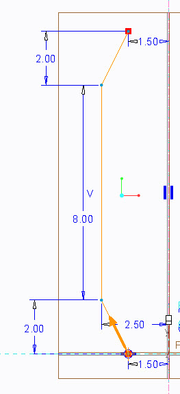

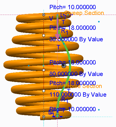

Hi, I'm a student in Sweden that need help with modeling a helical spring with pigtail and square ends at the top and the bottom of the spring. I understand how to create a helical spring but I don't understand how I create square and pigtail ends. If someone could help me with this it would be great.

Use helical sweep with varying pitch and trim the ends with an extrude cut.
February 15, 2017
What Kevin said.
Plus keep in mind the helix will follow the sweep profile so a straight line will
create a simple spring, or you can go with something like this

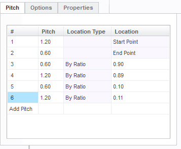

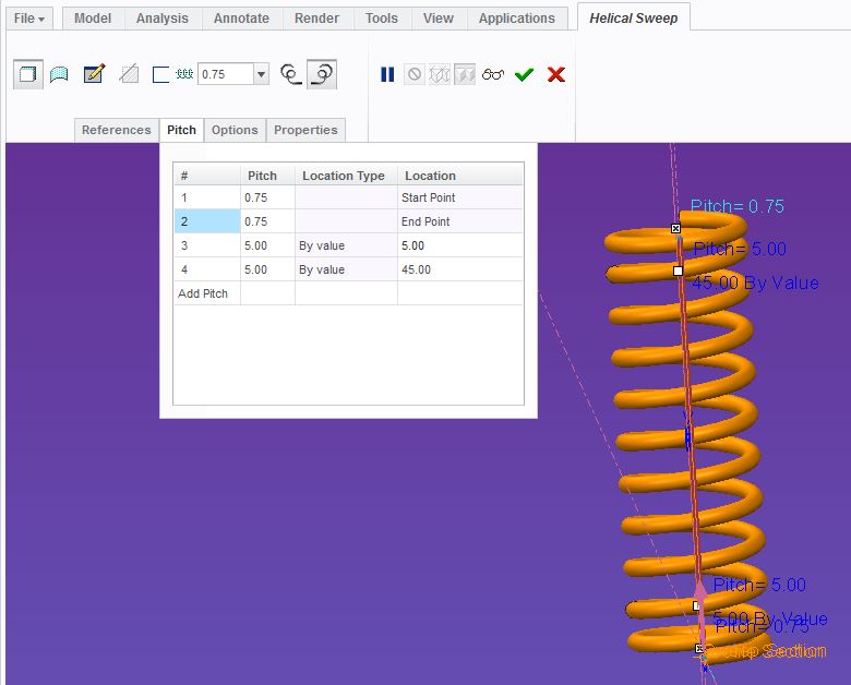

February 15, 2017
Attached is a helical sweep with the ends set like you want.  Below shows the profile sketch, this is how you get the diameter of the sweep to decrease at the ends.  I have also set pitch points within the sweep to make the coils closer together at the ends, and then after the sweep feature is completed, you can square the ends by creating planes and using solidify to remove material.
