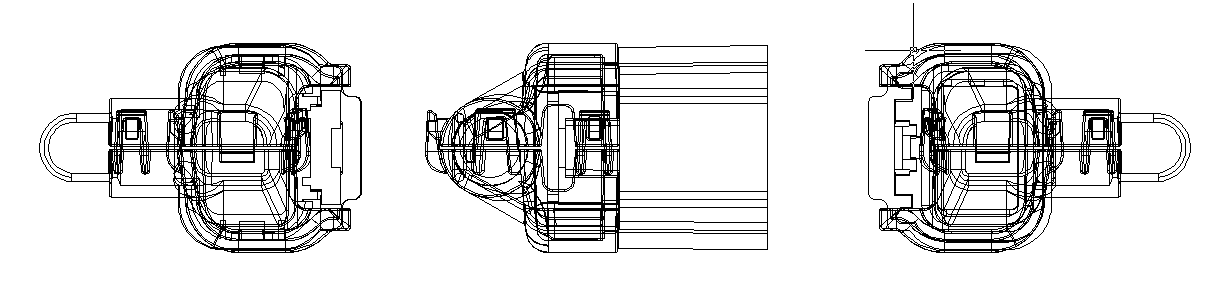

Now, I have another issue. When I pass the 3D to 2D there is some components that have a lot of lines, if I set no hidden it does not help.
Then I tried with a option called "Fast HLR for Drawing" it help me but when I see the component in other different program like .dwg I saw the lines again.

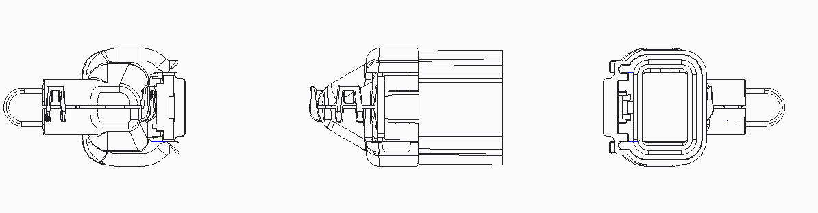

This is like it suppose to be at the moment of see the file:
This is how it is showed:
Regards.

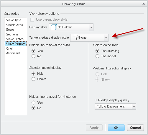

Those are tangent lines (edges of curved surfaces). Select the views, right click properties, go to the view display tab, set tangent edges to NONE.

Hi Stephen,
Thank you so much! I just set the option "Hidden line removal for quits" to "yes". Btw when I set "None" some lines that have to be showed dessapear.
But This work for me.
