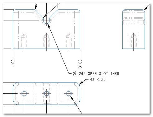

I've added a cosmetic thread to a tapped hole in order for it to show up in my drawing.  However it shows up in my drawing as two solid line circles when the inner circle should be solid line and the outer circle should be a hidden line.  How can I get the outer circle to show up as a hidden line circle?

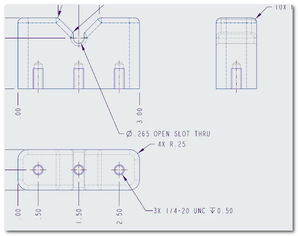

I figured it out.  The Creo drawing shows the tapped hole has two solid lines as shown in 2020-02-11_145918.jpg.  However, when I saved the drawing as a PDF, the major diameter circle "prints" as a hidden line as shown in 2020-02-11_150132.jpg.
