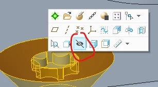

In Creo 7, I usually just select a surface on a part and select the hide button in the mini toolbar to hide a part.

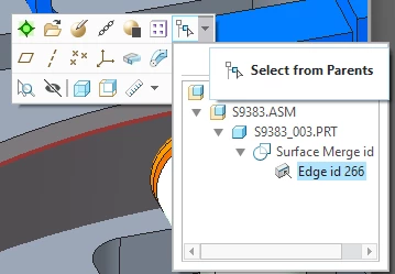

You can also use the Select from Parents button to select the assemebly level you want to hide then select hide.

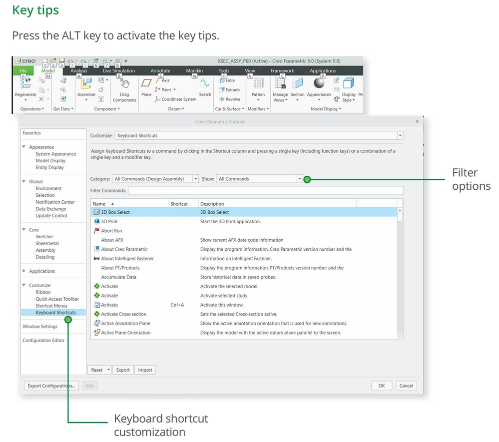

Creo Parametric keyboard shortcuts:
Hide is  ctrl+H
Unhide all is shift+ctrl+H
You can use these shortcuts in the definition of mapkeys. You must select an object (part/component) to hide before using ctrl+H .
