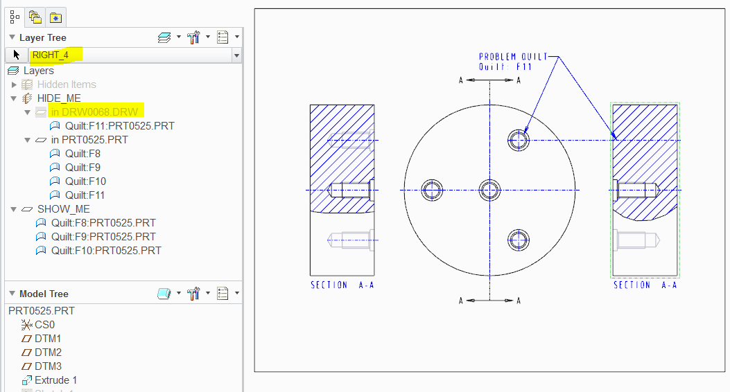

The next method is something I have pretty much adopted for all threaded parts: Put them on a "hide_me" layer. Now I can globally turn of the cosmetics where they are not needed. This is a model layer and does not really help in drawings other than the fact that you can select them using the drawing layer dialog. Again, this model layer is more for access at the assembly level.
In the drawing, you can now assign drawing specific layers. If you want, you can put every thread on its own layer if you need that level of control. What is nice about this is that now you can activate a view's layer status and then turn off whatever thread you want to not show.
In the image below, you will see a hide_me layer with all quilts created and shown in the part. I also created a drawing layer show_me and hide_me. I have the view layer status selected (Right 4) and I am using the drawing layers to hide the "afflicting quilt F11".
Again, for your purposes, it is only a problem with local sections and maybe a few other types of sections (offset?). It takes a little work to isolate the offenders and it is not something that should be an issue on every drawing. However, when the problem does show up, it is really difficult to come up with a consistent plan on how to deal with it, and further more, how to sustain these issues when someone else has to update your drawing. There is nothing automatic here! Your drafters will have to be aware as to what happens and how it should be handled. often times, it is simply a drafting oversight and perpetuated into many revisions making for a really messy, unprofessional drawing in the longrun. Adopting a consistent process to manage specific instances such as this is what Pro|WorkAround^tm procedures are all about.
Remember to save the layer status!

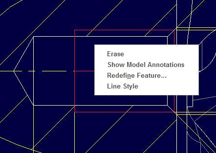

Suppression of unnecessary threads in view
  1. select the ribbon Annotate
  2. selection filter must be on General ( in right-down corner )
  3. choose the thread in view
  4. right mouse button – Erase

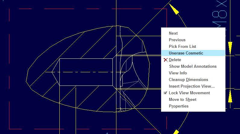

To resume the thread in view
  1. select view
  2. right mouse button – Unerase Cosmetic

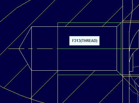

October 31, 2014
Thanks Martin. That helps clear up what is going on. I still had trouble selecting the cosmetic that remains in the forground of a local section. In that case, you have to window-select with model cosmetic filtering.

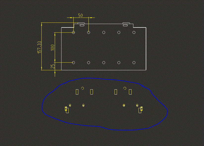

January 23, 2020
Hello to everyone,
I did a symmetric block in 3D, after that I did an extrude (with removing material) from half of it. My question now is how can I remove unwanted holes from 2D drawing whitch can be see in the picture attached (blue circle).
Many thanks.
