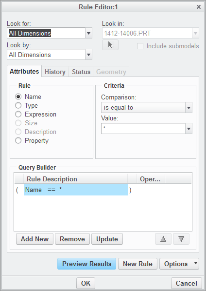

I'd first collect all model's dimensions as items of a layer by creating a layer "000_DIMENSIONS" that has this rule:

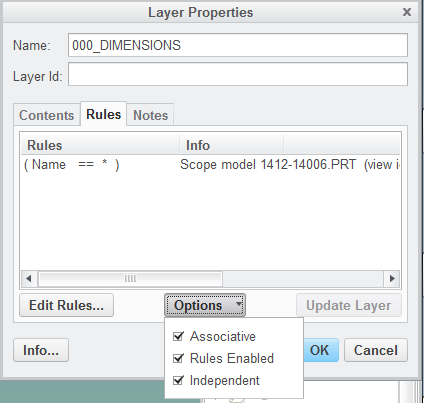

You'll probably have to use the "associative" option for the new rule to apply to already created dimensions:
From there, you can copy-and-paste items from the 000_DIMENSIONS layer into your custom layer that you'll hide in a particular view in your drawing...
