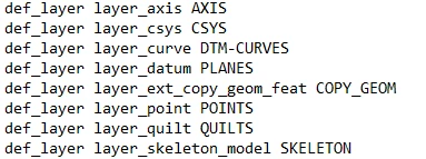

Can somebody tell me how I can add layers to the default-layers so that I don't have to create this layer again and again in every single part/assembly?

You need to update your templates to include all of the layers you need.
The other option would be to save a configuration file of the layers.  You can then open the configuration file to add the layers to your file.
Jul 7, 2020 12:42 PM UTC
Here are the options you can add to your config file.
PTC Info
Here's an example:

I would echo with @kdirth and @Tdaugherty and in addition to mentioned options you can use ModelCHECK to make sure that layers are as per defined templates.
Check details at CS208032

I've modified the templates and it works. It only seems that parts that already exist don't have those layers inside.
I added this line to the config-pro-file:
def_layer layer_curve DTM-CURVES
... and created a new part and assembly, but there doesn't seem to be a layer called DTM-CURVES in the layer-tree. What am I doing wrong ?
