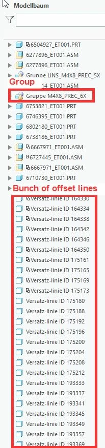

The offset lines in the parts tree cover a lot of space in assemblies. It takes a lot of scrolling up and down. All other elements of the tree can be grouped. Is there a possiblity to hide or to group the offset lines?

This has apparently been added to Creo 9.0.  See this product idea:
https://community.ptc.com/t5/Creo-Parametric-Ideas/Group-Offset-Lines/idi-p/458155
