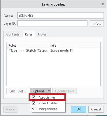

@ELDAFRAWY wrote:
Done all steps in the last reply, but when I hide the layer including the sketches, they are still visible.
Kindly find the part in the attachments with the pictures.
I do not have Creo 4.0 M150 installed, therefore I use Creo 7.0.5.0.
There are 2 problems related to your SKETCHES layer.
1.] The layer is empty, because you did not set its properties well. Please select Associative property.
2.] The layer is not hidden.
Select layer, RMB > Hide, RMB > Save Status, save part.

Couple of options:
1. In the model, hide the sketches and then switch to the layer tree and use "save status".
2. In the model, put the sketches on a layer. Then, in the drawing, go to the layer tree and hide that layer, then use "save status".
"save status" is the function that will keep things you set to hidden.

Assuming you are asking about sketched curves. The most robust approach is to put the curves (sketches) on a layer. In drawing mode set this layer display to hidden.
ELDAFRAWY12-AmethystAuthor
Dec 13, 2022 12:32 PM UTC
Is there a role to include all EXTERNAL sketches in one layer?
tbraxton
Dec 13, 2022 2:38 PM UTC
You can create rules for layers to include features when they are created. This should work for you r requirements. by adding sketched curves to a layer(s).
