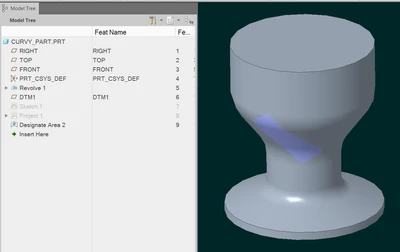

Another work-around:
In Creo 4 part-modeling, you can make a designated area on the surface:

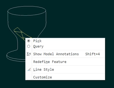

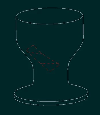

Then on the drawing, you can show the designated area on a (no)hidden line view and, you can change the "line style" of this feature.

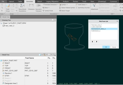

The trick I found is to switch to annotate tab before being able to select the feature:
then right-click and select "line style"
Funny thing, the tangent edges show through...

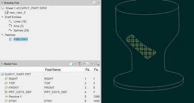

Another way is to convert the view to draft entities, then you can select the enclosed region and hatch it:
but that's a one way street...
