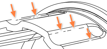

Hi Forum,
I have an *.asm assembly in Creo View 6.0, displayed in HLR mode as black and white line drawing.
When exporting that view to PDF ("Save Current View as 2D Vector File" -> PDF), most of the lines are missing in the resulting PDF.
If I export a single *.prt part from that *.asm assembly to PDF the same way, all lines are shown perfectly.
Thanks for help on how to export also the *.asm assembly with all lines visible in the resulting PDF.

SOLVED:
Don't use *.asm/*.prt file folders for viewing in Creo View -- PDF vector export will not work properly.
Instead, use *.pvz files -- PDF vector export will turn out perfect.

I stand corrected. Regardless of the format in which a part or assembly is loaded into Creo View, the problem with missing lines isn't fixed when exporting to PDF.
