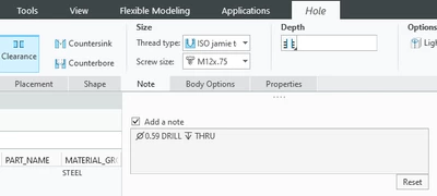

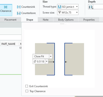

When we originally did our .Hol files over a decade ago we decided it wasn't possible to call out both FREE and CLOSE in the callout formats.  The Hole note on the drawing could only be shown as a Free(what we set it as).
Is that still the case?  When i add in CLOSE to the matrix/table it still just only gives me a Free callout and not the Close when Close is the value set in the model

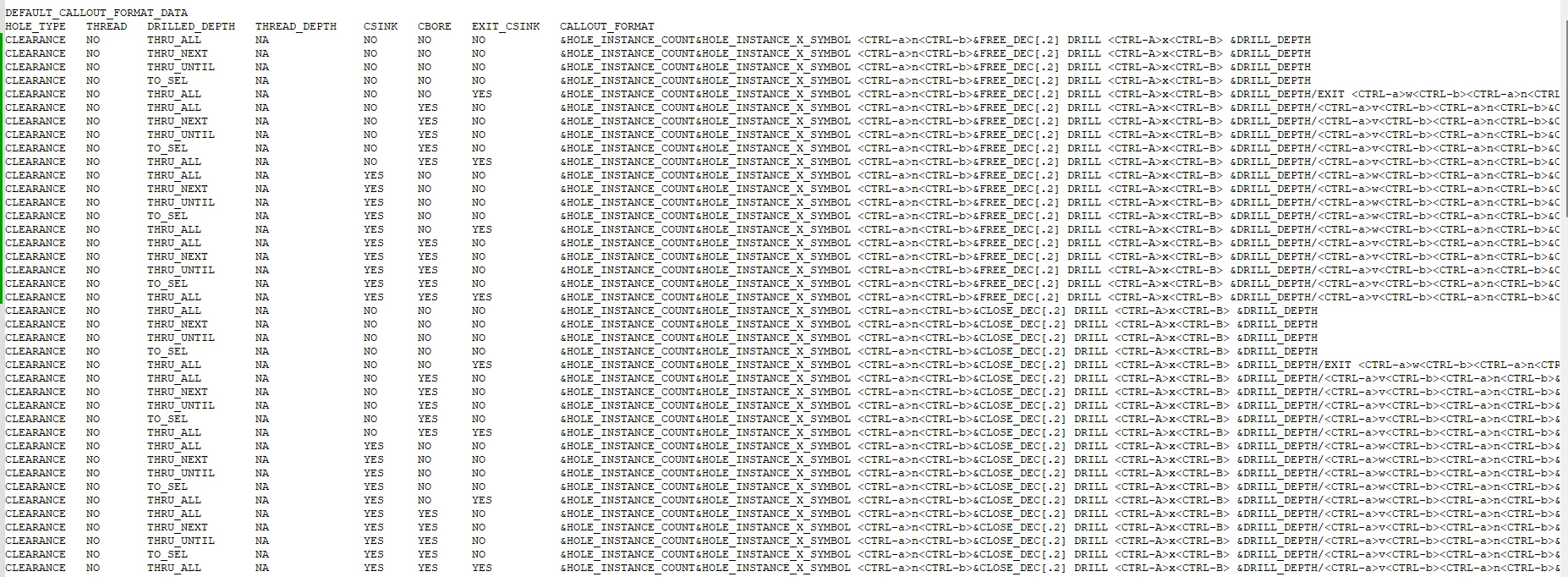

DEFAULT_CALLOUT_FORMAT_DATA
HOLE_TYPE THREAD DRILLED_DEPTH THREAD_DEPTH CSINK CBORE EXIT_CSINK CALLOUT_FORMAT
CLEARANCE NO THRU_ALL NA NO NO NO &HOLE_INSTANCE_COUNT&HOLE_INSTANCE_X_SYMBOL <CTRL-a>n<CTRL-b>&FREE_DEC[.2] DRILL <CTRL-A>x<CTRL-B> &DRILL_DEPTH
CLEARANCE NO THRU_ALL NA NO NO NO &HOLE_INSTANCE_COUNT&HOLE_INSTANCE_X_SYMBOL <CTRL-a>n<CTRL-b>&CLOSE_DEC[.2] DRILL <CTRL-A>x<CTRL-B> &DRILL_DEPTH

i changed Free Dec/Close Dec/Etc to report &DIAMETER instead of &FREE_DEC.  Working through some other stuff, but i think i got a handle on some of this after not looking at it for a decade
CLEARANCE NO THRU_ALL NA NO NO NO &HOLE_INSTANCE_COUNT&HOLE_INSTANCE_X_SYMBOL <CTRL-a>n<CTRL-b>&DIAMETER[.2] DRILL <CTRL-A>x<CTRL-B> &DRILL_DEPTH

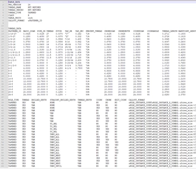

I created a custom NPT file.  I have it loaded into the directory that my other .HOL files are.  All of the straight drill .hol files are being read correctly, but the NPT .HOL file isn't being read.  I've renamed it to something different (thread series thread name) and I've also copied the same name as the commonfiles NPT file.  Neither is working.
Any ideas?
Any ideas?
there is probably an error in your file. Please upload it.
