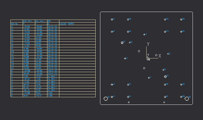

My problem is, there doesn't seem to be a way to insert the callout_format into the hole table, the callout format creates a note when enabled, but it would be much better for my needs if it created a parameter (which I can link to in the hole table) with the note in it self, or at least it would create a parameters which simply links to the note where the callout format is.

Its not automatic, but when I have come across this in the past I have just pasted the note variable name into the table cell. ie &Note_2:FID_759  You can get the note variable name (ie &Note_2:FID_759) if you right click on a note and then choose properties
