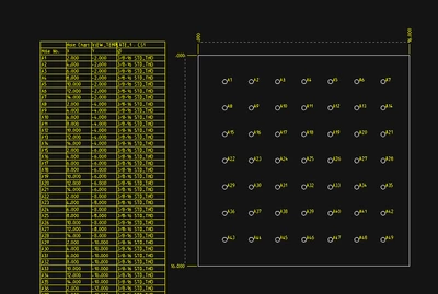

Here's an example of how we show where the origin of the table is.
Ty
