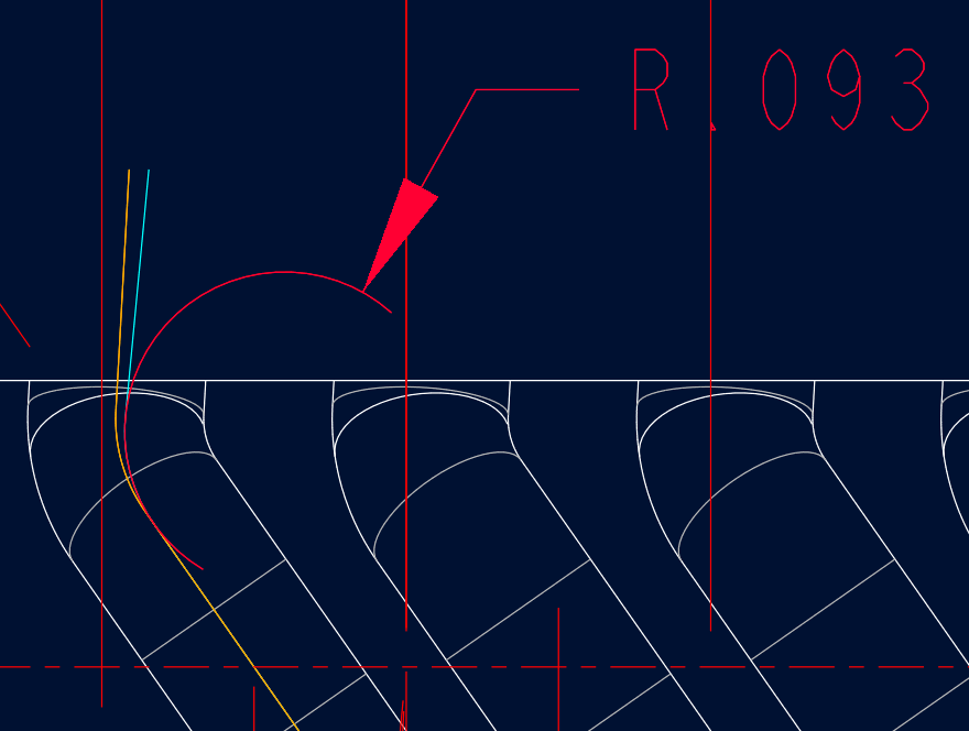

I want to add an additional leader to my drawing on the outside radius dimension to call out the internal radius with it.
How can I add the additional leader?

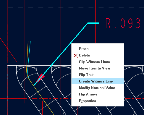

select your leader, RMB create witness line
shamrick1-VisitorAuthor
Jan 14, 2016 4:13 PM UTC
unless I'm selecting the leader wrong, this is what I get with I RMB:
No create Witness line
Jan 14, 2016 4:38 PM UTC
this is what I got
With that being said, you may have to select near the arrow, if a little box/circle appears, drag that around.
it means it was already created but just needs some lovin' to show up.
ron
ps - I am playing on CP2 if that makes a difference

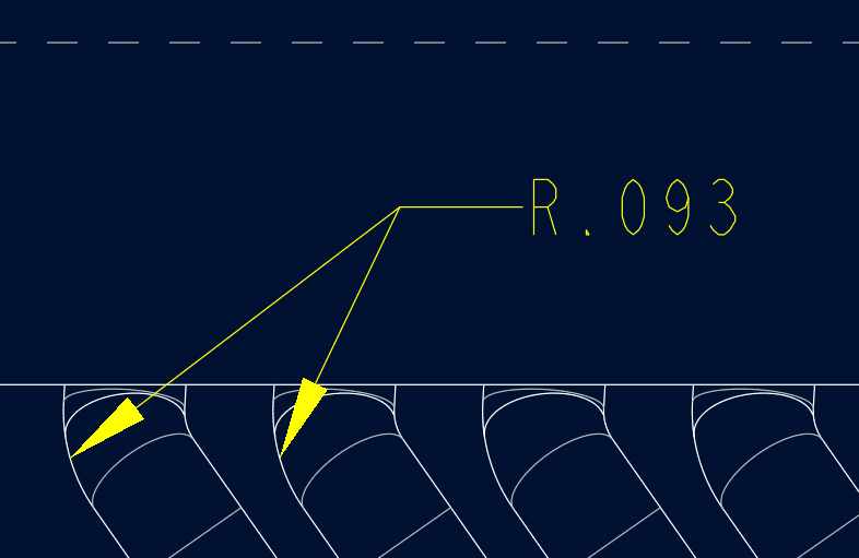

Jan 14, 2016 6:46 PM UTC
So you wanted to do this:
and not this:
