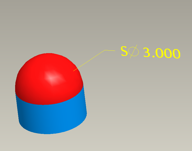

I have been trying to create a 3D dimension for circular/cylindrical features. Im actually using Creo Elements Pro 5.0. I'm using this feature.
Insert > Annotations > Dimension
I need to create the dimension on a pin once it has been assembled, so I can attach a datum to the dimension. Creating the dimension on an spherical features works pretty well but I didnt have any luck with cylinders. In the image below it is shown how I put the dimension on the red surface (the sphere) but I can't do the same for the blue one (the cylinder).

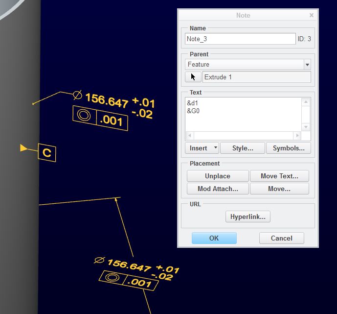

You can manipulate quite a bit of this. Datums can be assigned to several features; the diameter dimension can be shown as linear; the GTOL is a feature much like a dimension and can be added to a note feature. Orientation can also be edited.
I am certain you will run into limitations but maintaining associativity shouldn't be difficult.
Taking the dimensions to another level through an assembly should also be possible. You will have to find the feature in the sub-level and find the value as used in assemblies.

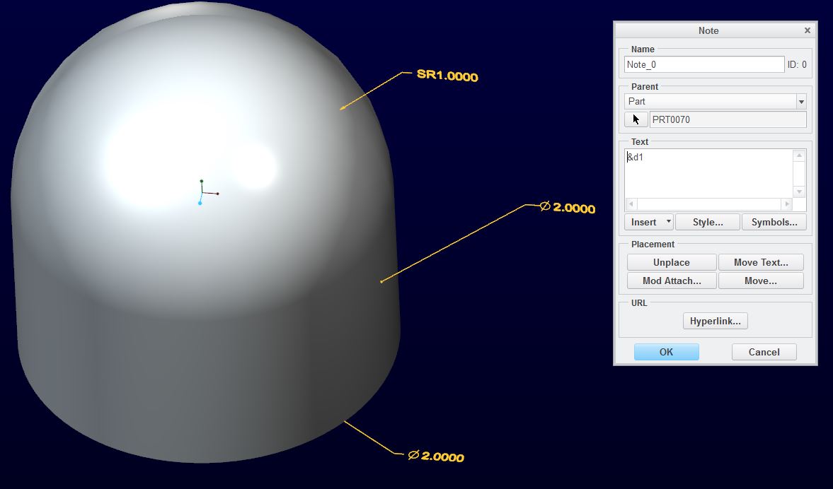

You can make a note annotation attached to the surface that used the dimension from the cylinder's diameter dimension.

I mean, if there is a way to do it with the feature I mentioned, Insert>Annotation>Dimension. I need to create the dimensions on the assembly, that way I can add datums and geometric tolerances to the assembly and show them on the drawing. Maybe my whole way is wrong, but at least it has worked for other things. I design with tooling balls so adding datums to the sphere is ok, but the problem is when I need to add datums to a dowel.

I see. Typically, you can only do what ASME Y14.49 will allow you to do. In the case of the cylinder, it is typically the dimension shown on the bottom. You can change the arrows-out but that is normally it.
However, that dimension, &d1, does have all the intelligence of the original. Have you tried formatting the dimension and then adding it to a note feature?
