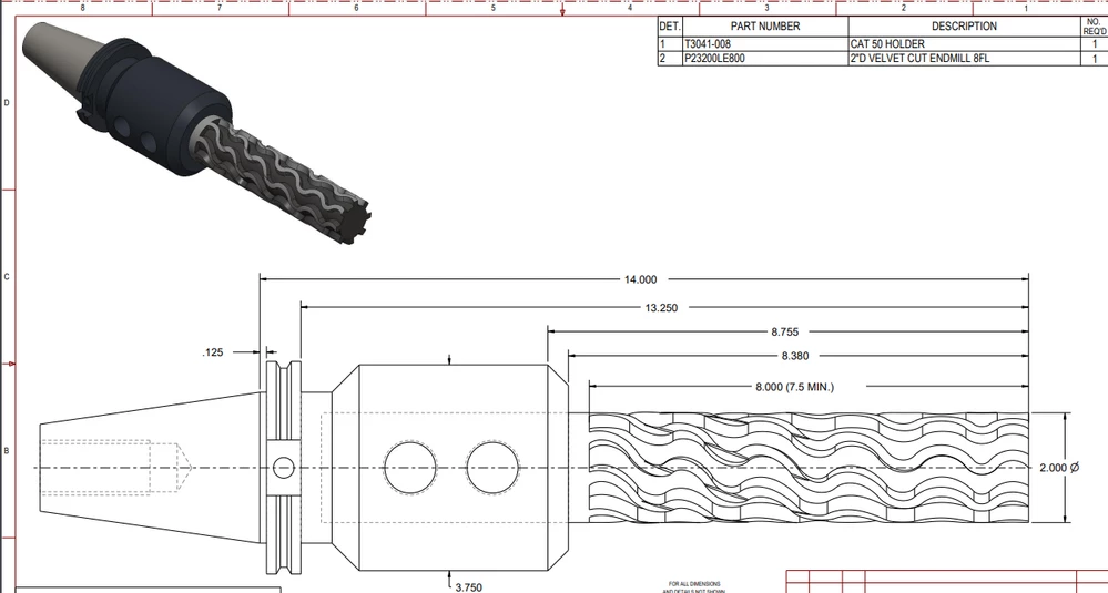

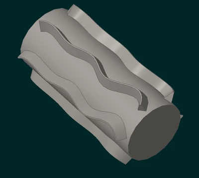

I am trying to recreate a velvet endmill, and frankly, I have no clue where to start with modeling this.  Usually, I use a helical sweep to model normal endmills, but this has me stumped.
pausobAnswer
Mar 31, 2023 1:32 PM UTC
Interesting, never seen one of these.

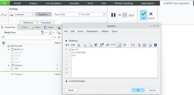

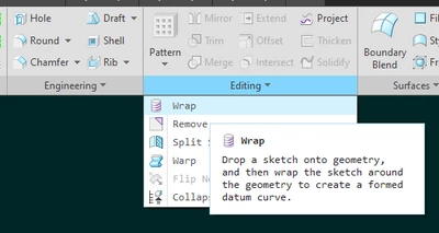

Off the top of my head, the variable section sweep using of trajpar equation involving (co)sine is the go-to for these kinds of "periodic" features.
But maybe the "wrap" tool could be used to get the snaking curve to follow the helical path around your stock cylinder?

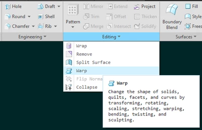

The other way would be to make a "straight" protrusion (with undulating sides), pattern, then twist using the "warp" feature:

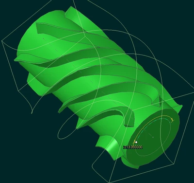

tool.pngThanks, I did end up going with the warp since with my skill level in Creo, it's much easily achieved.  And it doesn't need to be accurate, this is just used for tool sheets, and material removal simulation that only needs the diam and length to be accurate.

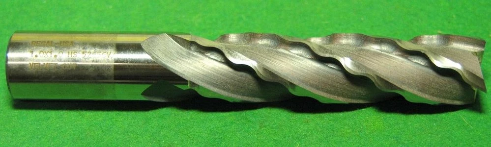

Ah.  That's why I mentioned whether you need it just for looks, or for accuracy, and that would determine methods needed.  Warp is excellent for things like this because it's actually very good at, well, "warping" geometry, in that it pretty much will not fail.  The downside is that you can't really control it, and you get what you get.  You can see that from the fact that at the distal end (from the chuck) that the twist is basically zero.  It's been a long time since I played with Warp (since I find it basically just a toy for my uses), but I think to correct that you can make that "bounding box" that's used to affect the geometry, be off the end of the part so that the twist actually affects even that end.  OR, make it longer than you need, and cut it off before the twisting stops.  I could be wrong, but I thought that was what I'd done years ago, the last time I played with it.
I guess what I'm surprised at the most is that they are finishing cutters.  I would have thought, from the similarity to the roughing cutter pic I posted, that they were a new roughing tool.  I've seen a lot of cutters in my time, but that's a new one on me.  Gonna have to look them up.

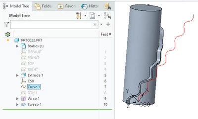

Mar 31, 2023 1:53 PM UTC
I agree with creating a wrap.  Create a coordinate system rotated on the Z and a curve from equation to wrap around the cylinder.  Then sweep the curve.

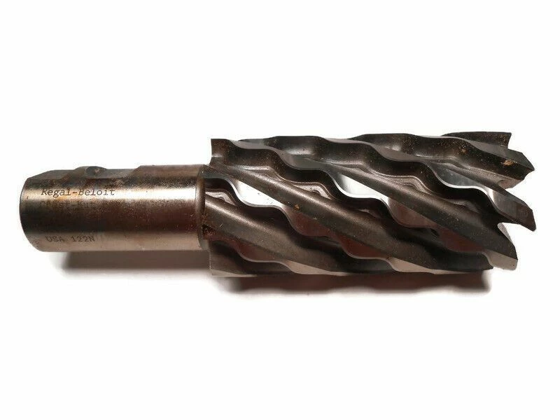

Interesting, I've never seen an endmill like that.  I can see the advantages for it though in breaking up chips.  Is it used for things like stainless that are a PITA to machine and/or for high material removal rates?
As far as actually modeling it, do you want something that just LOOKS kinda like it, or do you need to actually model the geometry?  If it needs to be accurate, you're going to have to measure it and that will probably determine your methods.  From what I see, a simple wrap isn't going to be enough.

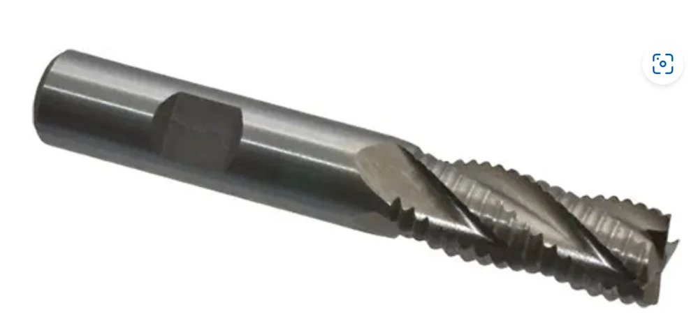

Patriot_1776
Mar 31, 2023 4:47 PM UTC
'Sup Ken!
Yeah, I've seen a bunch of "roughing" milling cutters over the years, some with "teeth" instead (to break up long stringy chips that break tools and FUBAR the material being machined), so, maybe this is simply a variation on that.  This example below seems to have MUCH simpler geometry (to model and especially to manufacture/grind the edges).  So, to me, this looks like it's made to be used on stainless or other "gummy" metals and/or for fast material removal.
