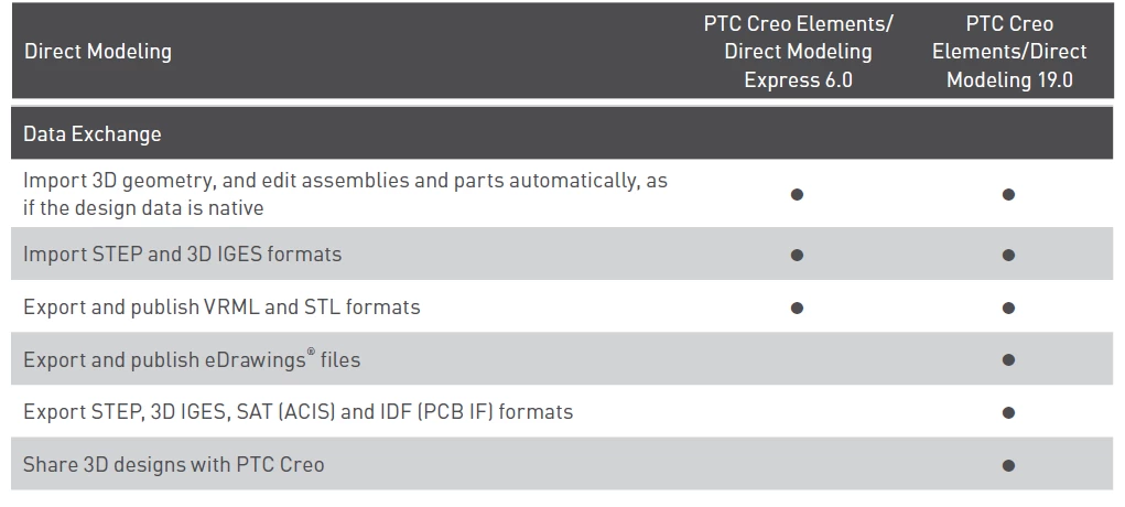

How can I create STEP files from CREO Direct Modeling Express?  "Help" mentions that it writes STEP files but can't load them, but Save as STEP isn't an option in my installation.  Am I missing a plugin?
9 replies
August 26, 2016
This can be done in PTC Creo Elements/Direct Modeling version, but not in Express release. In attachment you can find a comparison chart of this two versions of the program.
August 26, 2016
And only export and publish in VRML and STL formats. But I think one of the main limitations of the program is restriction in 60 parts for one assembly (which is very inconvenient when you have a lot of standard parts in assembly).
