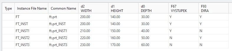

I defined family table

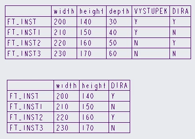

I created 2D repeat regions
Inside bottom table I defined filters
&fam.inst.param.name != depth
&fam.inst.param.name != VYSTUPEK
I set detail option
2d_region_columns_fit_text yes
Note: You can also use simple repeat regions to display family table contents.
Please replay video available on https://community.ptc.com/t5/Creo-Parametric-Tips/Creating-repeat-regions-to-display-family-table-information/ta-p/820021 page.
My test files created in Creo 7.0 are attached.
