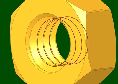

How can I design a thread in a nut? I always get problems with overlapping geometry.
Using the spiral tool and the threat geometry from the standard. In addition to that start and end of the thread are always not realistic.

Assuming you actually need to model the threads. Creo is fully capable of creating geometry for functional threads compliant with many specifications. Use a reference such as the Machinery’s Handbook to get the thread specifications and create the geometry in your model. Helical sweep functionality is the main tool used to create threads. One approach to get the proximal and distal end geometry of an internal thread is to use a boolean subtract operation of a solid (of the thread profile and pitch) that extends beyond the thread depth. This mimics an actual tapping operation for through holes as an example.

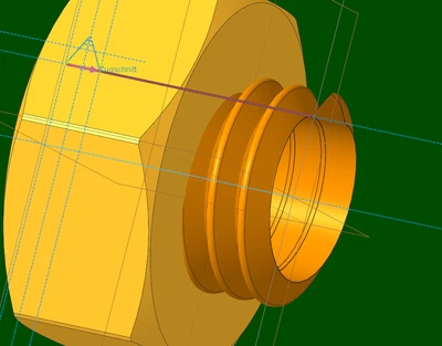

Hi, Thanks for the answer. I want to model the thread because I want to print it. I used the helical sweep and subtract the solid from the nut. But creo has obvious problems creating the solid because the helix is overlapping. I could only create surfaces. It works if I try to avoid overlapping geometry but then it remains a thin rim (2nd pic).

if you pack your part into zip file and upload this zip file, then user community can open your model and give you some advice.
