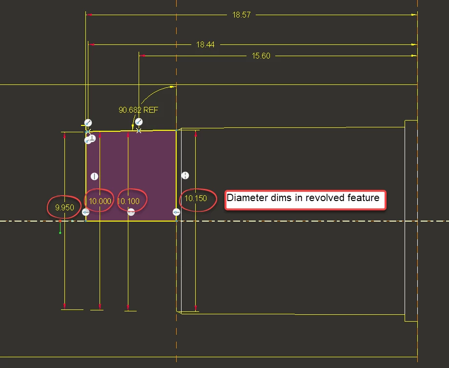

Oct 3, 2023 1:44 PM UTC
Example of dimeter dimensions in a sketch for a revolved feature.
This can be realized by the following:
Pick the axis, pick the radial point, pick the axis again, and place the dimension. (It can also be done, point, axis, point)
Oct 3, 2023 1:54 PM UTC
You can create drawing only dimensions that will give the shop floor what they need. You do not have to use the Show Annotations function to dimension a drawing.
When it comes to modeling a part, I have always tried to model it as it would be manufactured. This will drive the dimensions in a more useful way for the drawings going to the shop.
