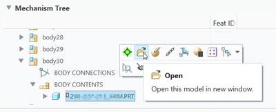

Dec 14, 2022 11:03 AM UTC
Thank for your reply, it did help me out as I wasn't aware of the Mechanism Tree (I'm so far only doing static assemblies, so it hasn't been relevant).
The issue in the error message seems to be related to parts that are partially constrained (therefore mechanism is expected, or??), but not all of them and I really can't figure out why (eg. there are partially constrained parts that don't generate an error).
The easiest why to identify the problematic part was to simply locate bodyX, expand the contents until you see the part and then open the part directly from there and edit the constraints. The Info -> Details way works too, but I find it practical not to have to open a new window just for viewing info.
