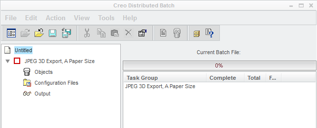

Sep 30, 2016 8:11 PM UTC
Creo Distributed Batch (was Pro/Batch) is a good option if you have access to it. 2016-09-30_16-10-42.png
Trailmaker 0.3 might be another option depending on how often you have to perform it on an entire structure and how much you want to automate it.
