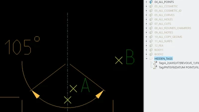

Note that these tags can be collected on a layer:
Then the visibility of that layer can be controlled on the drawing views, etc.
However, I don't know of a way to define position of these tags on the drawing...
