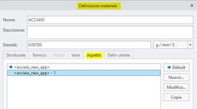

Hello everyone,
in the sheet of a material it is possible to associate one or more coloring aspects to it.
Trivial to create them, modify them and set which one should be the default, but I have not found any way to delete them!
Can you tell me how they can be eliminated?
P.S. I use creo 9.0.0.0

I think you can open material file in Notepad and remove unwanted line from it.
