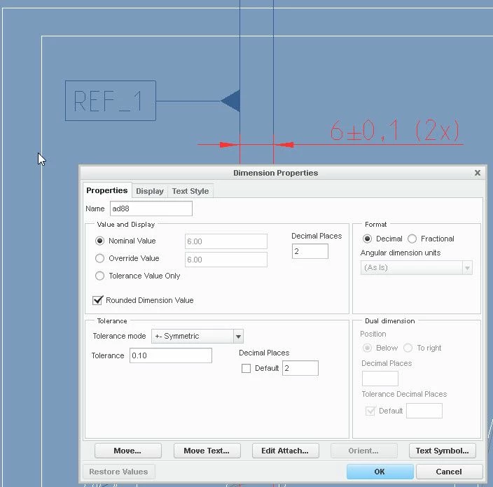

How do I add zeros after the decimal place? (Creo 2 Drawing) ?

Best answer by melreynolds
Hi MaheshSh, that has worked.
I needed to select "Std_English" to allow the inclusion of zeros.
Thanks for both your help guys.
Best regards,
Mel

I have set the decimal places to 2 however the dimension still displays without any zeros. Also the over-ride option does not work.
KenFarley
January 21, 2019
Is this a metric drawing? I believe the standard is to have no trailing zeros on metric dimensions and Creo upholds that standard. I don't know if you can override the behavior, but if so it's got to be a "drawing.dtl" setting.
January 21, 2019
Yes it's a metric drawing. I've tried a few settings but i have not been able to display as 6.00
