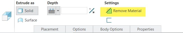

    Depending on how the cut was created it will a be different method. Look at your feature to see if you have the option to remove material when you redefine the feature. Look for this icon to remove material.

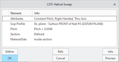

    No, I don't have that option to Remove Material. A different window opens up when I choose Edit Definition.
