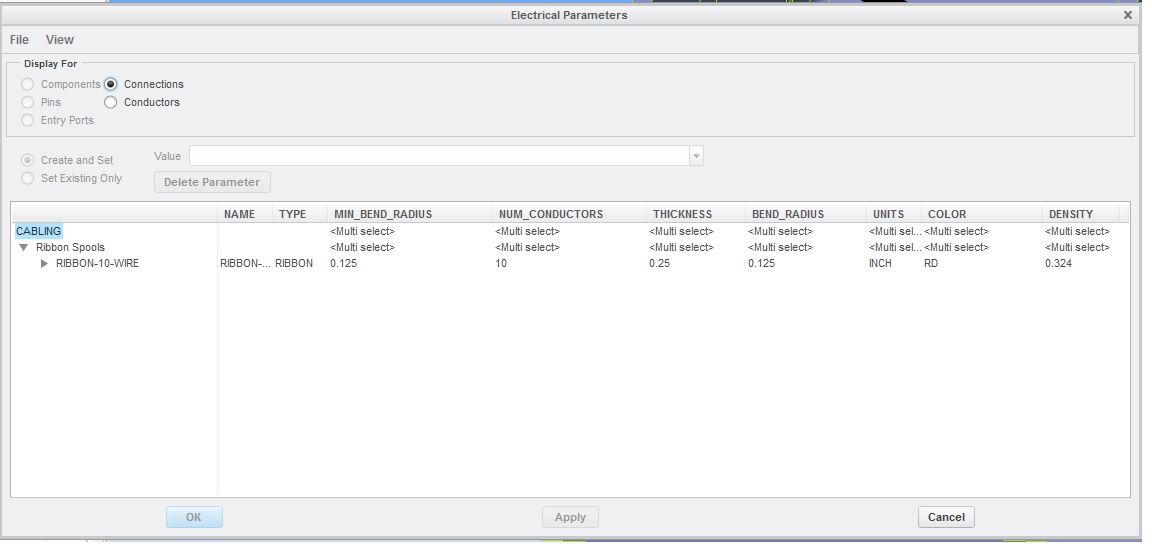

How do I change the mass/density of a harness part? I tried to change the mass properties and got zero pounds. I tried to change the spool parameters density, again to no avail. Any input?

Hi Adam,
In case of RIBBON Cable, set DENSITY parameter for each conductor in order to get mass properties calculated correctly.
