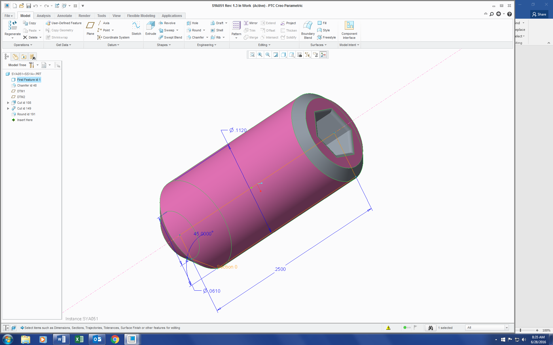

Ok, trying to work with Cero 3.0....migrated from wildfire 4.0.....  the fastners in 4.0 are not showing up in cero 3.0, I cannot find any Socket Head Set Screws, inch or mm in the tools menu.
How do I get them into the new IFX drop down system.. It seems to havw some libs already, were do I find additional lis

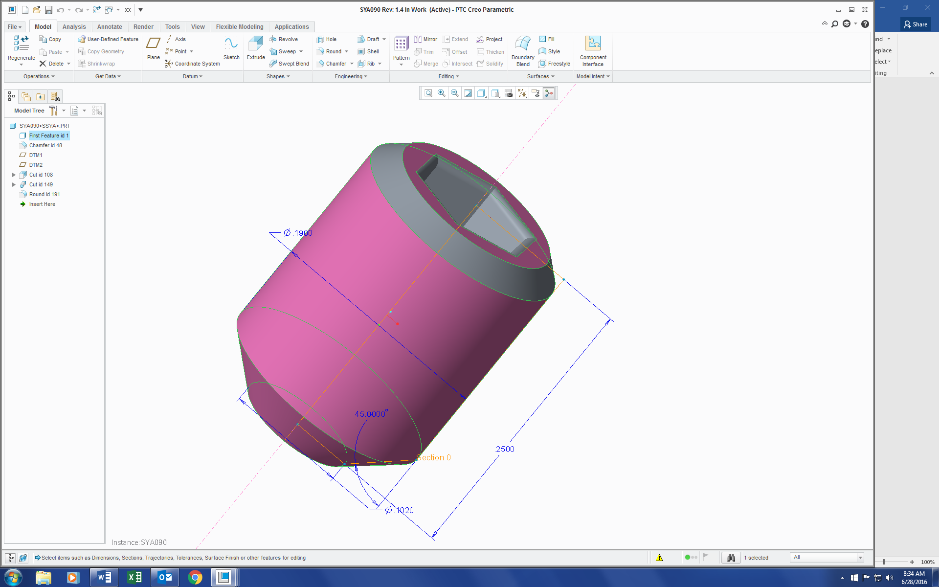

Hello, I am not sure no longer have access to Wildfire 4.0, It was at lease build code M110
Here when loading "Legacy Data" while connected to Windchill server the screws are replaced...The screw part number like CSDD208.prt is the same
WIndchill replaces it with a different size.   It use the same size screw and replace various size screw on the legacy assembly.
I cannot locate any small Socket Head Set Screws in the tool drop down....  do you know what is meant by the term"Out of the Box Library"
Do I need to load additional Standards ???  If yes were are they located and how do I determine which standards are right for Us ??
Any in-depth documentation on this ??

Hi Chris,
IFX is shipped with the ProLibrary from PTC.
The files are located in subfolder: <creo loadpoint>\Common Files\afx\parts\prolibrary
In this folder you also found a search.pro.
By default the option "search_path_file" is set to this search.pro.
It seems like that you have legacy parts with the same name as we have in our ProLibrary files.
If you set the Creo option "display_full_object_path" to yes you can see where are the files loaded from.
I think you have to remove/rename the search.pro file so that no search path to the ProLibrary files is set. The you leagcy data will be loaded again corretly.
Not all files from the ProLibrary can be assembled with IFX. The setscrew for example can not be assembley by IFX.
This type is not supported yet.
You can include your own fasteners to the IFX - library. You find a beginner and an advanced tutorial in the PTC Help Center.
Introduction to PTC Creo Intelligent Fastener
Oli
