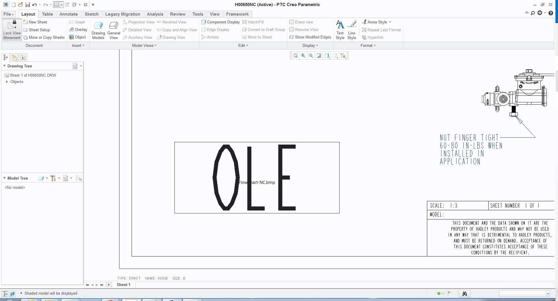

How do I insert my jpeg flow chart into my drawing?
Hello;
     I'm trying to insert a flow chart that didn't come in when imported a dxf into a Creo drawing. If I try object, create from file, I get just Ole Ebbedded over a small rectangle that says FlowChart-NC.bmp. I think the answer is through the object create new, but then I'm not sure how to create the flow chart image on the spot. Anyway any help is greatly appreciated, in that I'm a SolidWorks user, just trying for the end game of out putting a CGM file.

Hello;
     I tried that but got the same rectangular image as with the jpeg.

I thought perhaps clarify my post. I would like to insert a jpeg, or bitmap using the insert object into a Creo drawing. I have the jpeg, &,or bitmap created, but when I try insert object (Create from file), all I get is a rectangle with OLE etc. Instead of the Image. Anyone know how to do this?
Thanks in advance;
Rob_D     PTC Creo 3.0 M050

Check article https://support.ptc.com/appserver/cs/view/solution.jsp?n=CS43569
Changes suggested in article needs access to system registry, you may need to involve your IT.

The reliable method is to create a part with a surface and apply the picture as a texture. Remember to set the config option to save the texture with the part. Then add the part to the drawing as a view. This will let you easily manage the bitmap.
save_texture_with_model yes
PTC depends on 3rd parties to render bitmaps for drawings using the OLE (object linking and embedding) tech. It depends on having a client registered to handle the data type. Using a part model uses the internal bitmap management and does not depend on 3rd parties or changes to the OS registry.
