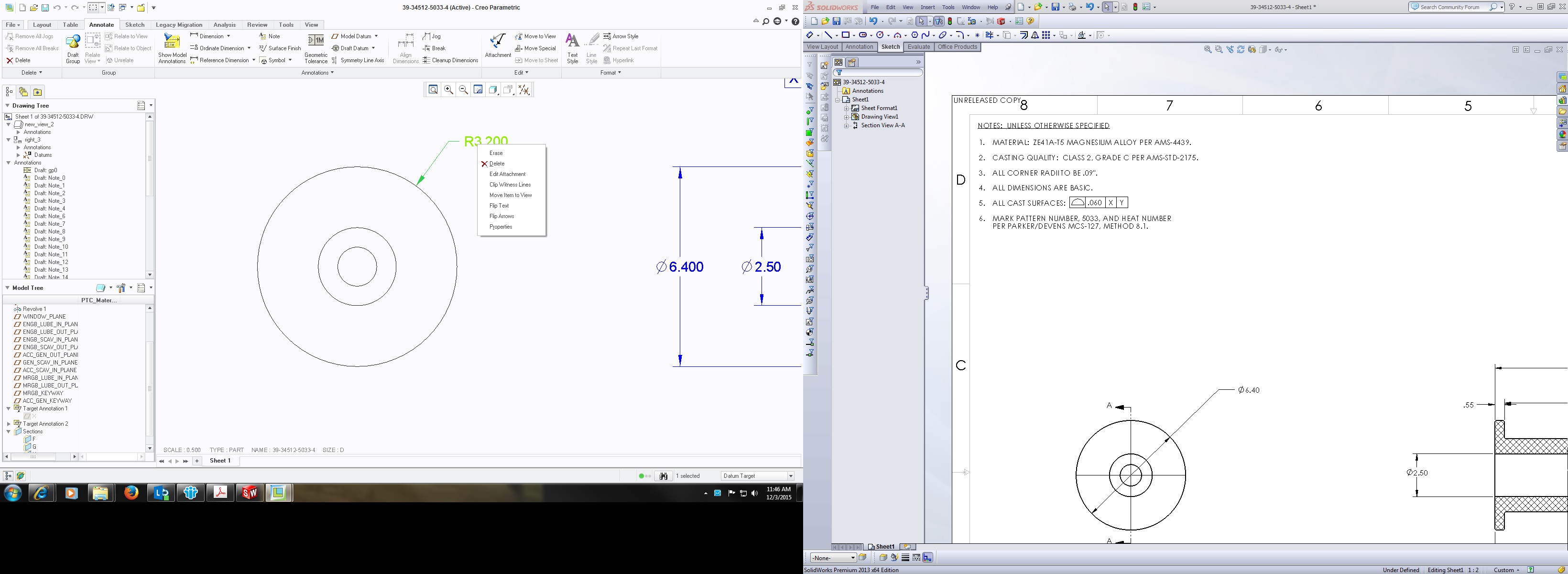

I have added the datum in my model.  It is dropped on the surface and is difficult to see but that is acceptable in the model.  Once I bring it into my drawing, the datum flag appears on the model geometry and I need to move it off.  It does not allow me to select the flag.  Any idea's?

Do I have to create a datum flag symbol of my own?  I don't see one in the pallette symbols.  How do I redefine the attachment?  I go to the model and try to redefine but it drops it on the same surface.  See screen shot below:

Switch to the annotation tab, it will let you select the datum (if you still have trouble, use the smart filter at the bottom rh corner and set it to datum)
It should show drag handles (little white squares), the one on the triangle is for the extension line. DONT pick the drag handles, just pick and hold around the letter or within the triangle an it lets you move the datum.

One more question from a new user.  How do I convert this Radius to a Diameter.  I thought it was a right button option.  You can see it was created as a dia in the model and comes in as a dia when I use model annotations.
December 3, 2015
I use old-school... Click the arc twice before placing the dimension.  Select once; radius... twice; diameter.
