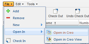

Are you in PDMLink?  If so then you can check the boxes of all the objects you want and select File > Open in Creo.
