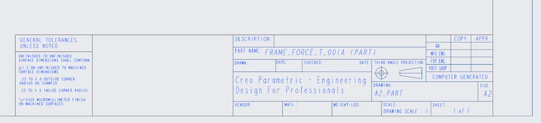

How do you change the text in the title bar?
How do you change or write the text in the title bar?
kdirth
Jul 17, 2026 11:56 AM UTC
There are two types of text in the “title bar” to change.  Both are set in the drawing format.  One is text defined in the drawing format and the other is text is pulled from part or drawing parameters.
Those referencing parameters, such as description or part name are changed by changing the appropriate parameter.
The hard codded text, such as titles and standard notes, and references to a parameter are changed by editing the drawing format.
Which type of text do you want to change?
The format is updated by reapplying the format to the drawing page and model parameters are referenced to the currently active model.
