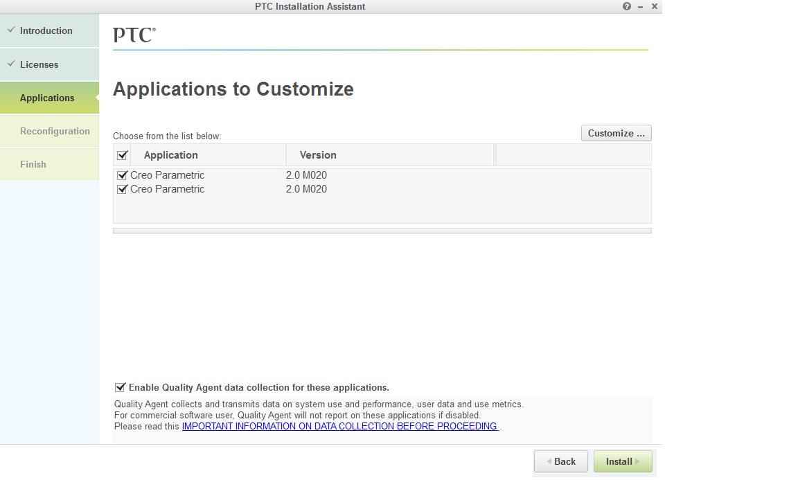

I clicked on the Style icon and nothing happens. I guess I should expect this if ISDX was not installed.
It is possible that ISDX was not installed during my startup.
I did try to "reconfigure" the license; but I'm not seeing any options to add the ISDX extension.
I am seeing some strangeness in the "Applications Customization" window. I am surprised that there are 2 seperate product listings.
I can hit the customise icon in this window and still don't see any extra options.
I'll attach my window.

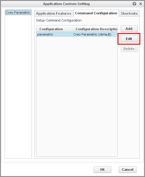

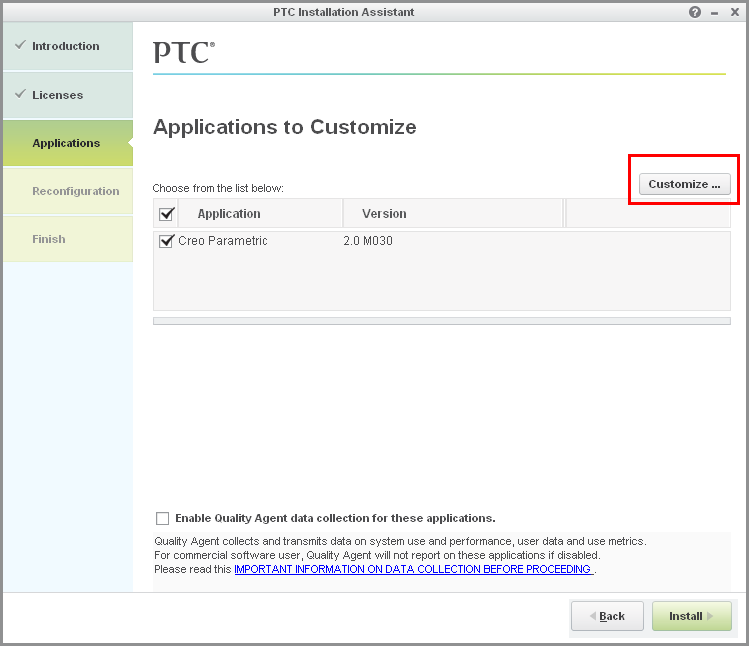

Below you can find pictures saved from Creo 2.0 M030 installation.
I run Creo 2.0\Parametric\bin\reconfigure.exe.
Then I clicked Next several times to get the following dialog.
I clicked Customize.
I clicked Edit.

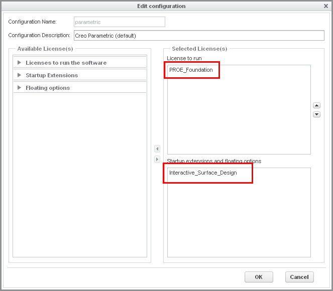

I set basic license and extension.
Then several OKs and I was finished.

Perhaps there is a simple tutorial somewhere on installation or reconfiguration but I find it hard to know what options to even use. You've pointed out the Edit Command Configuration which I missed.
I see Mechanism Design and ISDO available to enable but not Interactive_Surface_Design.
Also; once I go through the installation I'm seeing that it doesn't keep the options that I did add.
