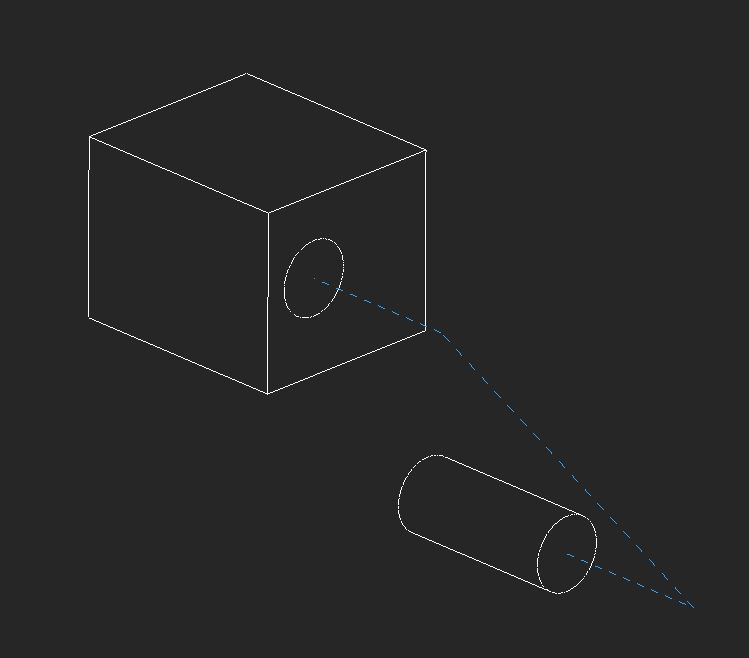

Welcome to the forum. If I understand the question, you are seeing this:

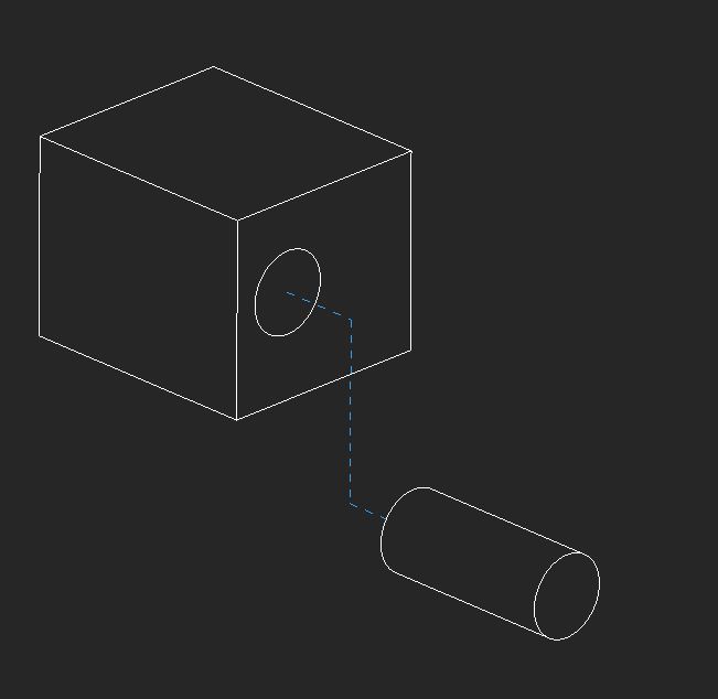

When you want to see this:
to do this, you cannot flip the line, instead you must create a new line. To make sure the explode line comes out on the correct side, you must be careful when picking on the axis. The explode line will come out of whichever end of the axis that you select, so to get the explode line coming out of the left hand side, pick the left hand end of the axis.
