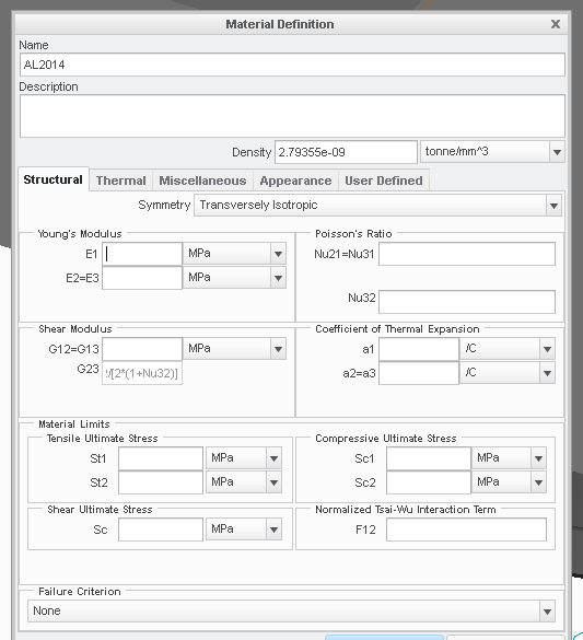

I would like to apply orthotropic material properties to a single part in my assembly model and have created a coordinate system for this component.   When I try to edit my material to apply orthotropic or transversely isotropic properties, I cannot find a way to link these to my component coordinate system.
Is there a way of doing this?

I just found that you apply the orientations in the material assignment.
That is the correct answer.

October 30, 2015
In the table above there are boxes for E1 and E2/E3.  How does one know which directions these properties are for?  If one wishes to have certain properties apply directionally to a local coordinate system which is different than the global coordinate system how does one do that?

October 30, 2015
