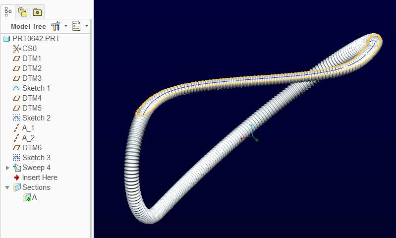

How draw corrugation Tube?
We always draw corrugation tube with "helical sweep" , I don't think it is ok, because the tube is continue, but helical sweep should not continue, it is only helical, how draw it?

October 17, 2015
If I understand, you do not want the helical part of the sweep, right?
If this is correct, have a look here...
Creating bellows with VSS and trajpar?
October 18, 2015
This was created with Creo 2.0 commercial version using VSS.
This can be tricky to get a highly accurate version, but for a representative version, this is probably the most robust.
