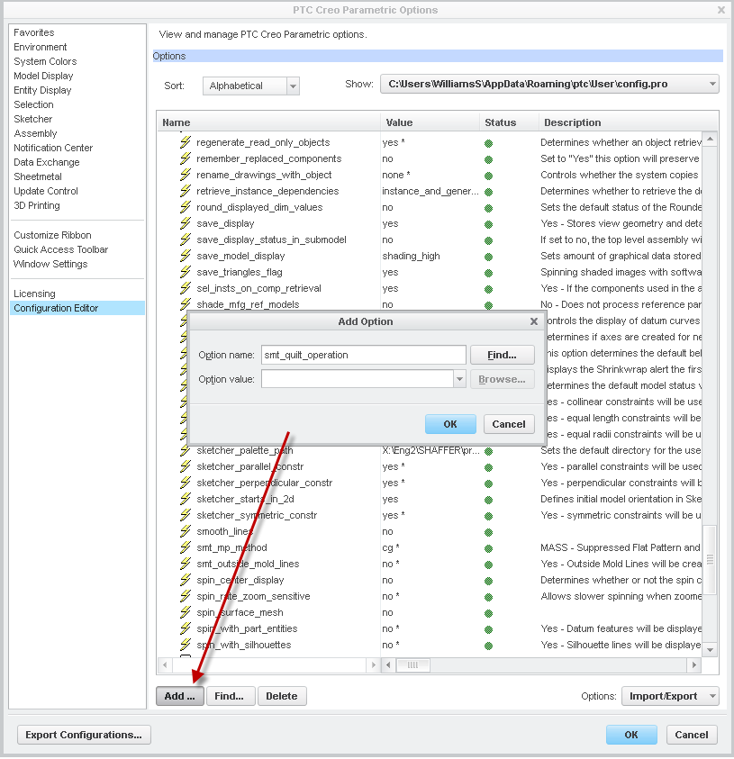

Anybody help me please !
I want to define in obtion, " smt_quilt_operation" ( It is hidden ) but I can not find this obtion.  How can I find it ?
StephenW
December 27, 2016
Use the Add button in the configuration editor, type the option and also type the "value" you need for the option, then click OK.
