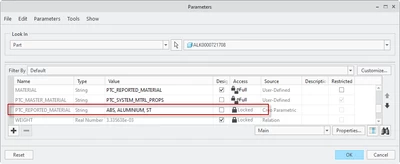

As with Creo 7 there is the multi-body added. In this situation it is possible to use multiple materials in one part. When this is the case there is a parameter PTC_REPORTED_MATERIAL created which contains the name (I think it's also the condition name) of the used materials separated by a ",", see below.

"The system parameter PTC_REPORTED_MATERIAL is used to report materials in the BOM table and to view all materials assigned to the part. You cannot edit this parameter. You also cannot use it in relations. At part level, the parameter PTC_REPORTED_MATERIAL reports all the materials assigned to all bodies in that part. At body level, this parameter reports the actual material assigned to the body."

  • Using multi-body with different materials gives a list in PTC_REPORTED_MATERIAL

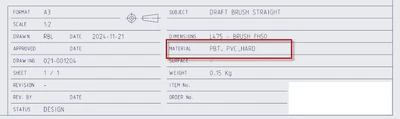

  • Adding this PTC_REPORTED_MATERIAL to a repeat region and set ptc_reported_material_in_region to multi-material shows  a nice horizontal list of the used materials in case of muti-body with different materials (so "&PTC_REPORTED_MATERIAL" results in "Steel, Wood" for example) (sse also screenshot below).
